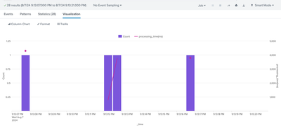

How can I also create a time series graph on same graph where x axis is time and then y axis is a bar chart of count column + line chart of new processing_time(ms)

(First, thank you for providing data emulation.)  Do you mean something like this?
This feature is called "Chart Overlay" in Splunk search visualization.  You open "Visualization", select "Bar chart" as base visualization, then, in "Format", select "Chart Overlay", as in this illustration:
For illustration purposes, I also selected "View as Axis" "On" because the two measures are too different numerically.
But back to your search.
You are doing lots of calculations that do not contribute to this end goal.  If you really want to extract potentially useful information, I would suggest the following
| rex "\S+ \S+\s\[(?<somenumber>\d+)\] (?<log_level>\w+) (?<class>\S+) \[(?<someoutput>[^\]]+)\] - (?<message>.+)"
| rex field=message "^(?<action>[^\(,]+)"
| rex field=message ", used (?<db_bulk_write_time>\d+) (?<time_unit>\w+)"
But the simplest search would be
index=abc sourcetype = example_sourcetype
| transaction startswith="Saved messages to DB" endswith="Done bulk saving messages" keepevicted=t
| where db_bulk_write_time > 0
| eval duration = duration * 1000
| timechart span=500ms max(Count) as Count sum(duration) as "processing_time(ms)"
Note I use span=500ms just to make some useful graphs.  You need to adjust to your needs. (And decide whether sum is the correct stats function in your use case.)

The screenshots above are produced from this emulation by customizing search period to the interval represented in mock data.
