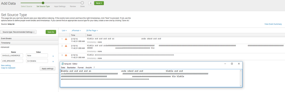

martin_mueller
Looks fine to me:
The text editor formatted for line breaks to fit the window, it's one long line as in your example.
