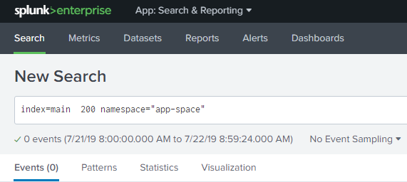

I am doing search on data coming from fluentd k8s.

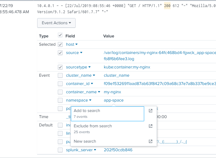

On top of that data , I wanted to filter on basis of field.
Add to search field prompts that, there would be count of 7 events. But surprisingly its Zero.
So I did some trial and error to put wildcards to get data. Here it is.
index=main 200 namespace="*app-s*pace*"
Now all the & events shows up !!
My Question is Why is this happening?
And why -s*pace.
In some fields, keeping * also does not give accurate events.

I had no intention to do namespace="*app-s*pace*" as the result did not show on app-space . I did this trial and error and added these * around the string.
If you see the 1st image, the field is a plain string. app-space and also suggest 7 events will appear but clicking on it (2nd image). Zero events.
