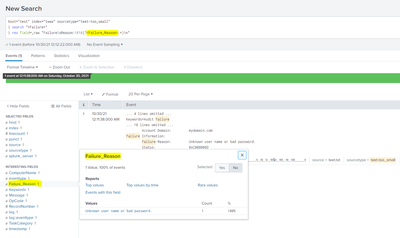

Hi Splunkers,
I have prepared a regex extraction using regex101 site, and now trying to extract "Failure Reason" as per below log but for some reason fails.
Where is the catch? Should be pretty simple but I am out of ideas now.
Search:
| from datamodel:"Authentication"."Insecure_Authentication"
| search "*Failure*"
| rex  "Failure\sReason:\t\t(?<Failure_Reason>.*)\n"

Hi,
The solution is to adjust the quotes on the data model. One easily missed I guess.
| from datamodel:"Authentication.Insecure_Authentication"
| rex field=_raw  "Failure\sReason:\t\t(?<Failure_Reason>.*)\s"

vhharanpositka
Hi Vagnet
You can try this @vagnet ,
| search "*Failure*"
| rex field=_raw  "Failure\sReason:\t\t(?<Failure_Reason>.*)\n"
vagnet
Thanks @vhharanpositka . Same results though
vhharanpositka
Hi @vagnet
This is working for me.
vagnet
Thanks @vhharanpositka . It works using index searching, but when searching inside the datamodel. This is what I am trying to figure out.
Regards,
Vagnet
