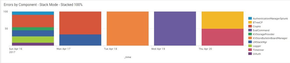

Updated - Based on the example, you are looking for changing the Stack Mode from Visualization Settings to Stacked 100%. This feature is available in Splunk. By default Stack Mode is set to None, so you are not seeing Stacked series in your chart. PS: Stacked Mode is applicable to Column Chart, Bar Chart and Area Chart.
Added Sample screenshot and options for changing the Stack Mode to Stacked 100% from UI or Simple XML.

Is this for Column/Bar Chart? Can you add a screenshot of what output you want from Tableau?
mblauw
I know this, but it will still display 0-100 instead of 0%-100%
