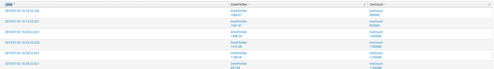

I have events in my logs that look like
     linesPerSec:    1694.67
     message:    Status:
     rowCount:   35600000
     severity:   info
when i make a search like:
index="apps"  app="my-api" message="*Status:*" | table  _time,  linesPerSec, rowCount
This is what my table ends up looking like
How do I get the number value away from the key for both linesPerSec and rowCount? I want to see all instances. I tried using values(linesPerSec) but that seemed to aggregate only unique.
Thanks,
Nate

reinharn
Thanks for the response!
If I wanted to get those values into the table how would I go about that?
index="apps"  app="my-api" message="*\Status:*" | table linesPerSec, rowCount | rex field=_raw "linesPerSec\:\s+?(?<linesPerSec>\S+)[\S\s]+rowCount\:\s+?(?<rowCount>\S+)"
I still get the table values as the key/value.

reinharn
Just tried that. Still doesn't seem to like to separate the values. Here is and image of what I am seeing.

reinharn
That worked! Thanks so much!
