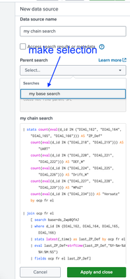

yuanliu
I'm not sure if I fully understand the question.  But first of all, do not use join.  Second, if you must use join, just create a chain search to invoke that join.  Place your first search in a main search - in the editor, this is called a Search.  When you create chain search, the editor asks you to select a parent search.
As you have already set up the main search, all you do is to put the rest of search into a chain search that chains to that main search.  You do not "reference" a base search.  You chain to it.  Like this

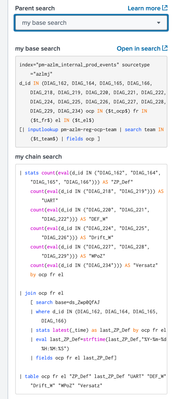

After you make that selection, your main search will be displayed in a grayed area
Thirdly, do not use join if you can help it.

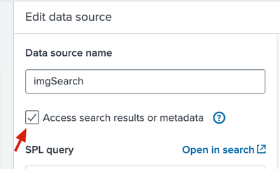

livehybrid
HI @Ste
If you edit your base search and then tick the box to "Access search results or metadata" then you can use an field from the search elsewhere in other searches/panels
e.g. you can then do $imgSearch:result.<fieldName>$ in this case
Would this give you what you need?
