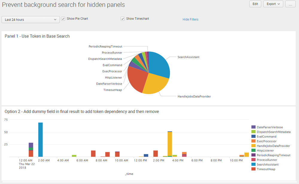

@wang you can create token from Checkbox in a way that same token is also used in the panel search which is depended on the checkbox.
1) First option is to have token from checkbox set in a way that it can be added to the base search itself.
2) Second option is to use the token in the search query after the final pipe. Set a dummy field with token value and then use field - to remove the dummy field afterward.
Following is a run anywhere search based on Splunk's _internal index explaining both options:

PS: In order to show the behavior in sample dashboard, I have not used the tokens in depends attribute to hide panels when the searches are waiting for input.

Implemented Option 2 and it works well!
One minor issue is that if the time picker window is relative like -10m (last 10 mins) and the checkbox for the hidden panel/searche is clicked 5 mins after the initial display for the dashboard, the time window for the hidden search is different from the original time, i.e. deplayed by 5 mins.
How can I capture the time window when the main dashboard is displayed and use that for the hidden search?

      <chart>
        <search>
          <query>index=_internal sourcetype=splunkd log_level!="INFO" component="*"
| timechart count by component limit=10 useother=f
| eval dummyTokenToPreventSearch="$tokShowTimeChart$"
| fields - dummyTokenToPreventSearch</query>
          <earliest>$tokTime.earliest$</earliest>
          <latest>$tokTime.latest$</latest>
          <sampleRatio>1</sampleRatio>
        </search>
        <option name="charting.axisLabelsX.majorLabelStyle.overflowMode">ellipsisNone</option>
        <option name="charting.axisLabelsX.majorLabelStyle.rotation">0</option>
        <option name="charting.axisTitleX.visibility">visible</option>
        <option name="charting.axisTitleY.visibility">visible</option>
        <option name="charting.axisTitleY2.visibility">visible</option>
        <option name="charting.axisX.abbreviation">none</option>
        <option name="charting.axisX.scale">linear</option>
        <option name="charting.axisY.abbreviation">none</option>
        <option name="charting.axisY.scale">linear</option>
        <option name="charting.axisY2.abbreviation">none</option>
        <option name="charting.axisY2.enabled">0</option>
        <option name="charting.axisY2.scale">inherit</option>
        <option name="charting.chart">column</option>
        <option name="charting.chart.bubbleMaximumSize">50</option>
        <option name="charting.chart.bubbleMinimumSize">10</option>
        <option name="charting.chart.bubbleSizeBy">area</option>
        <option name="charting.chart.nullValueMode">gaps</option>
        <option name="charting.chart.showDataLabels">none</option>
        <option name="charting.chart.sliceCollapsingThreshold">0.01</option>
        <option name="charting.chart.stackMode">stacked</option>
        <option name="charting.chart.style">shiny</option>
        <option name="charting.drilldown">none</option>
        <option name="charting.layout.splitSeries">0</option>
        <option name="charting.layout.splitSeries.allowIndependentYRanges">0</option>
        <option name="charting.legend.labelStyle.overflowMode">ellipsisMiddle</option>
        <option name="charting.legend.mode">standard</option>
        <option name="charting.legend.placement">right</option>
        <option name="charting.lineWidth">2</option>
        <option name="trellis.enabled">0</option>
        <option name="trellis.scales.shared">1</option>
        <option name="trellis.size">medium</option>
      </chart>
    </panel>
  </row>
</form>
