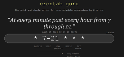

kiran_panchavat
@Santosh2 As per your query, "my alert should not trigger between 9pm to 7am I used below corn job but I am receiving alerts after 9pm".
So, It means the Cron job should run between 7AM to 9 PM correct? In this case, you can try this.
* 7-21 * * *
Hour: 7-21 (Every hour from 7 AM to 9 PM)
Did this help? If yes, please consider giving kudos, marking it as the solution, or commenting for clarification — your feedback keeps the community going!

Assuming you mean cron not corn, try checking your expression with something like Crontab.guru - The cron schedule expression generator
Santosh2
I did it it’s saying it won’t run from 9pm to 7 am
but it’s not working
