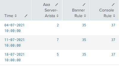

Compare the row values to the above row.
vinod743374
Communicator
Compare the row value with the above row value ,
if the above row value is grater than the  present row value, it should be replaced with the above value,
otherwise remains same.
i have a table like the above image,
you can observe date wise sum data , third row values should compare with the  second row , if it is grater than the above value it should replace with the higher value>
if anyone suggest me any other method , it would be also appreciated.
i think you guys understand, what i requested ,
please help me out

ITWhisperer
| streamstats max(*) as *
ITWhisperer
Please can you clarify what would happen if a fourth row had value 4 in the second column, should this be replaced by 5 from row 3 or 7 from row 2 via row 3?
vinod743374
Communicator
thanks for the response ,
yeah it should replaced by 7 only ,
it should replace with the higher value in the column.
if our 4th row has the highest value , it should remains same.
the same should work for all the rows.
thank you !!
ITWhisperer
| streamstats max('Aaa Server-Arista') as "Aaa Server-Arista"
vinod743374
Communicator
if possible , can't we generalize the query for all the rows.
ITWhisperer
vinod743374
Communicator
It working ,
Thankyou so much !!
kamlesh_vaghela
@vinod743374
Can you please try this?
Your_search
| streamstats window=2 earliest(A) as pre_A
| eval A=if(pre_A>A,pre_A,A)
or
Your_search
| autoregress A as pre_A p=1
My Sample Search :
| makeresults | eval _raw="A	B	C
2	35	37
7	35	37
5	35	37" | multikv forceheader=1
| table _time A	B	C
2	35	37
7	35	37
| table _time A	B	C
Thanks
KV
▄︻̷̿┻̿═━一
If any of my reply helps you to solve the problem Or gain knowledge, an upvote would be appreciated.
vinod743374
Communicator
thank you for the response <
with your query,
it replaces with the  the previous value ,
but in my case , it should return when ever the value is grater than the present value, otherwise it should remain same.
