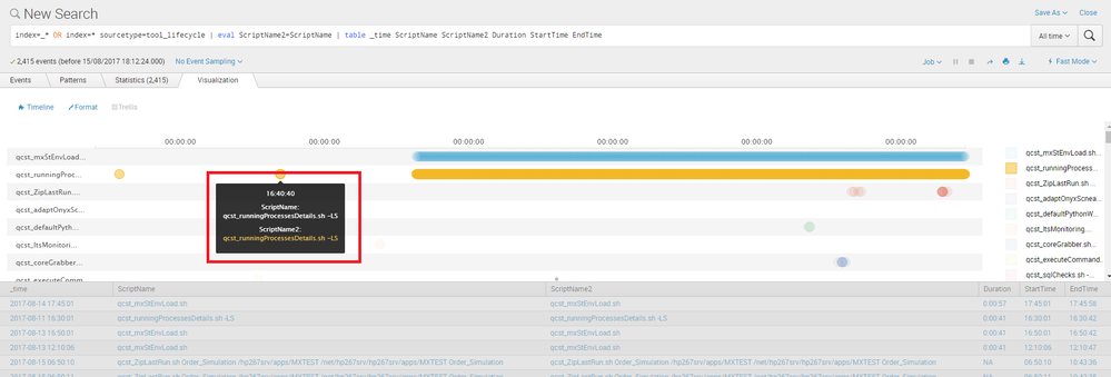

Hello,
In Gantt chart, when we move the mouse over an event it displays a pop-up box with certain details. By default, its displays only 3 columns (_time , ScriptName, ScriptName2). Is it possible to display other columns (Duration, start-time, end time ) on pop-up box ?
Search Query:
index=_* OR index=* sourcetype=tool_lifecycle | eval ScriptName2=ScriptName | table _time ScriptName ScriptName2 Duration StartTime EndTime
Attached Screenshot.alt text

It looks like you're using the Timeline app, the documentation is found here for simpleXML options:
https://docs.splunk.com/Documentation/Timeline/1.1.0/TimelineViz/TimelineXML
it doesn't look like you can add other fields.
There is a Gantt Chart app found here: https://splunkbase.splunk.com/app/1741/ that can be customized.
