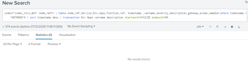

I'm a beginner on Splunk. I would like to have your help today on a project that I am doing. I have to calculate the availability of application services. I have an entry from a database using Splunk DB connect. in these data I receive all the events listed in a DB of a monitoring Tools. I would like to calculate via the timestamp the duration of an incident between the moment when the status is failed and the return to normal. it is difficult because an event can occur several times in the day so I have to find a foreach which will read a line with a severity 2 "critical" and its return to normal for this line with severity 0 "OK" using the timestamp because its return to normal occurs after of course. I don't know if I managed to explain the problematic. thank you for your precious help.

Hi @wcastillocruz,
at first, do not use the table command before the transaction command, use it after transaction.
Then try to use quotes in startswith and endswith.
At least, to debug transaction, try the transaction without startswith and endswith and/or without one of the other transaction keys, maybe you have too many conditions and there isn't any results to all your conditions.
Ciao.
Giuseppe

wcastillocruz
Hello @gcusello, sorry to reply late. I tried your suggestion. it seems to be correct but I cannot determine the value of "startswitch" and "endswitch". this is a value of the Env Apps varname columns? I added another column: description and use the value "FAILED" for "startswitch" and "OK" for "endswitch" but it doesn't return anything.
gcusello
Hi @wcastillocruz,
Ciao.
Giuseppe
