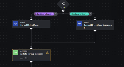

I have not encounter this error previously. When I join two code block to an action block using the visual editor. A join_***_***_1 block will be created.
This auto generated block is using the the "code_name" parameter which is triggering the unexpected-keyword-arg error.

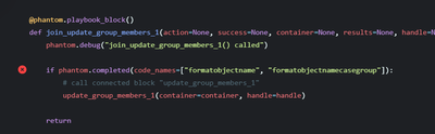

This code_name is not valid per the docs, but its being placed there by the gui editor behind the scence.  I cannot edit the join_ function without breaking the gui restrictions and going straight code. (classic playbook)
here is example:
@phanTom.playbook_block()
def code_7(action=None, success=None, container=None, results=None, handle=None, filtered_artifacts=None, filtered_results=None, custom_function=None, loop_state_json=None, **kwargs):
    phantom.debug("code_7() called")
    ## Custom Code Start
    # Write your custom code here...
    ## Custom Code End
    join_code_9(container=container)
    return
@phantom.playbook_block()
def code_8(action=None, success=None, container=None, results=None, handle=None, filtered_artifacts=None, filtered_results=None, custom_function=None, loop_state_json=None, **kwargs):
    phantom.debug("code_8() called")
    ## Custom Code End
    return
**** This part is auto generated by the SOAR GUI editor*****
def join_code_9(action=None, success=None, container=None, results=None, handle=None, filtered_artifacts=None, filtered_results=None, custom_function=None, loop_state_json=None, **kwargs):
    phantom.debug("join_code_9() called")
    if phantom.completed(code_names=["code_7", "code_8"]):
        # call connected block "code_9"
        code_9(container=container, handle=handle)
    return

The phantom.completed method doesnt take a code_names param, the function accepts the following:
phantom.completed(action_names=None, playbook_names=None, custom_function_names=None, trace=False)
 Check out https://docs.splunk.com/Documentation/Phantom/4.10.7/PlaybookAPI/PlaybookAPI#:~:text=action%20and%20... for more details on the phantom.completed method

However, as mentioned earlier. This block of code is automatically generated when I ammend the visual editor. Changing the "code_names" to either "action_names" or "custom_function_names" will result in disabling the visual editor. Which would create a big trouble for my future development of this playbook.

you can replace "code_names" with "custom_function_names", it will pass linting and work, but like you said, it will force you out of the GUI editor. I've put in a support ticket.  they should just update that GUI editor to use the documented parameter and we'll be back on track.
