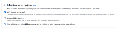

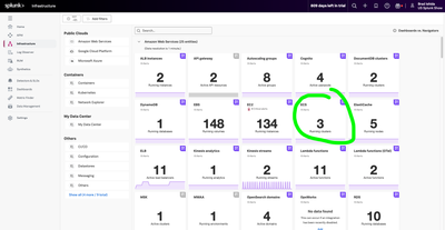

We tried AWS integration from Splunk's Data Management/Add Integration/AWS, which connected successfully.
Anyway, we noted that the ECS widget shown in your image doesn't show unless we have an EC2 ECS cluster, but not for our use case, wich is a Serverless (Fargate) Cluster.
Do you know if theres is any way to poll this kind of cluster information?

Have you connected your AWS to Splunk Observability Cloud? If so, you should be able to see an ECS navigator in the Infrastructure view.
https://docs.splunk.com/observability/en/gdi/get-data-in/connect/aws/get-awstoc.html
Another possible option is to check out Metric Finder and search for ecs.task.* metrics and build a chart using them and save it to a dashboard. Since you already deployed the OTel collector as a task, it should be sending in ecs.task.* metrics.
