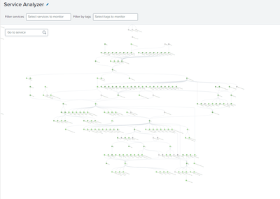

we are using ITSI Service map/Service Analyzer to monitor services.  we have an use case where for same service we need to add multiple KPI and those KPI depends on different entities.
For Example: We have Infrastructure related KPI which uses host as entity, another KPI is "service Up" which basically check service is up and in this case entity is "process name".  Also have KPI for Garbage collection which also has different entity.
Question: I am trying to understand which is the best way to handle such scenario. where we can add all these KPI without making service map too complex.
