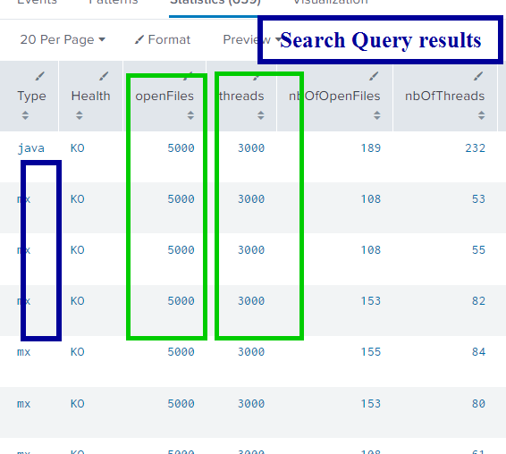

Hello,
I am looking to use a lookup in my search query. basically  in lookup, I have 2 rows for threshold  and I wanted to use them in my search query as 2 column.
Screenshot of csv and search query  requirement.
Lookup
expected search query results
I tried like this. but not sure if there is better way to implement this requirement.
| appendcols
[| inputlookup test.csv
| table MetricName Threshold
| where MetricName="threads"
| rename Threshold as nbThreadsThreshold
| appendcols
| where MetricName="openFiles"
| rename Threshold as nbOpenFilesThreshold
| filldown nbThreadsThreshold nbOpenFilesThreshold
Thanks
kamlesh_vaghela
@AKG1_old1
Can you please try this?
| appendcols [
| inputlookup test.csv | table MetricName Threshold | where MetricName IN ("threads","openFiles")
| transpose header_field=MetricName | table threads openFiles]
| filldown threads openFiles
Thanks
KV
▄︻̷̿┻̿═━一
If any of my reply helps you to solve the problem Or gain knowledge, an upvote would be appreciated.
kamlesh_vaghela
@AKG1_old1
| appendcols [
Thanks
KV
▄︻̷̿┻̿═━一
