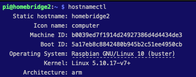

rpi specs:
os details:

You are probably using a 32bit raspberry pi os and trying to run the 64bit UF
last ARMv6 is 8.1.9 universal forwarder
