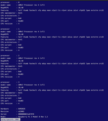

trying to forward logs from node process that runs on a raspberry pi model 3b
the error i get when i try ti run the splunk universal forwarder on my pi
running the file command on the splunk executable returns this result:
of course i downloaded the arm version of the universal forwarder.
any help will be much appreciated
rpi specs:
os details:

You are probably using a 32bit raspberry pi os and trying to run the 64bit UF
last ARMv6 is 8.1.9 universal forwarder
