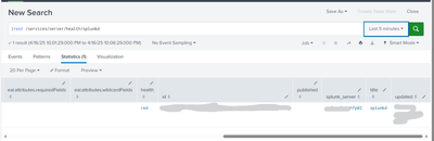

How we can get the health status of the HF,UF and IHF which are connected to DS while using the rest am able to see the health for the MC ,CM, LM,DS, Deployer and IDX etc but not able to get the status health which is in Red Yellow green and not getting .
Rest which am using is - | rest /services/server/health on MC am able to see health status of  MC ,CM, LM,DS, Deployer and IDX but not for forwarders also while am running the same query opening any of the HF U.I am able to see there health results.

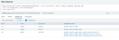

If you are wanting a high level view of a forwarder then you can use the health.log using the following SPL
index=_internal host=yourFowarderHost source="*/var/log/splunk/health.log"  | stats latest(color) as color by feature, node_path, node_type, host
If you have a number of forwarders to monitor then you could adapt this to score the colours and show the worst?

I need the health status for HF while running the query. There are more than 5 HFs, and when I run the query for each HF individually, I get the results. However, I can't create a single alert that covers all HFs and —doing so would result in more than 5 separate alerts, one for each HF.
If am running the same query in LM and able to see all components status in a one go can't it be possible for the HF and IHF

If you just want to see the health by host then you can try the following which will report hosts with red health checks:
index=_internal host=* source="*/var/log/splunk/health.log"  | stats latest(color) as color by feature, node_path, node_type, host
| stats values(node_path) by color host node_type
| where color="red"
