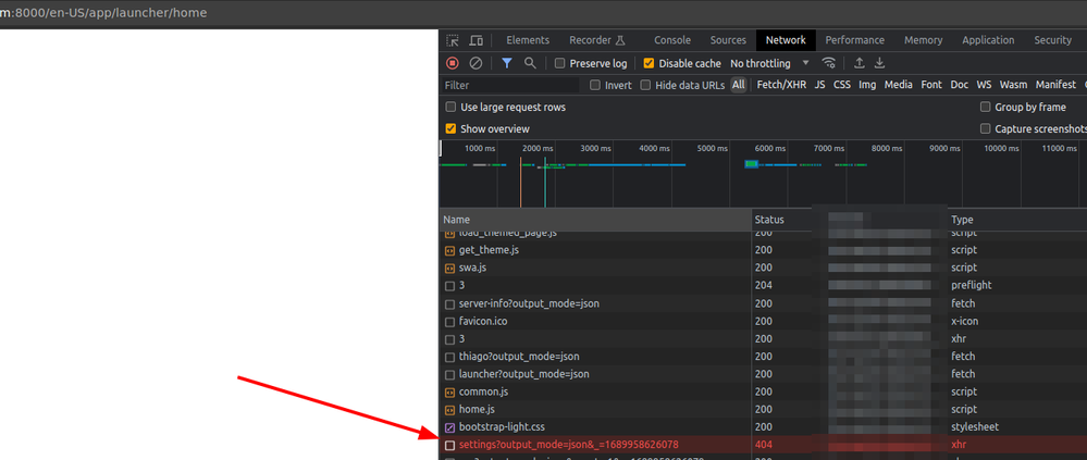

Hello everyone, I'm encountering an issue with the web interface for the deployment instance. When I attempt to access it, it prompts me for a username and password, but after entering the credentials, it gets stuck on a loading gif that keeps spinning indefinitely. Upon inspecting the network tab, I noticed there's only one resource returning a 404 error: https://my-deploy-instance:8000/en-US/splunkd/__raw/services/dmc-conf/settings/settings

What do you mean by "provisioning a new instance on my cloud, adding my configuration files, and starting the process"? You spin up a newer version and copy over your files(which ones)? Or you install a new old-versioned splunk instance, copy over files (again - which ones), upgrade this instance... And then what? So many questions 😉
And the licensing - why aren't you just using a license master? Anyway, you're not supposed to use the same license on multiple splunk instances (and Monitoring Console will complain heavily if you do).
