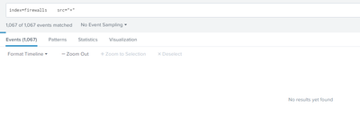

So I have this very strange problem. We have 2 SearchHead environments. 1 SearchHead Cluster(7) and a Standalone Dev SearchHead. They both are connected to the same indexer Cluster.
A new problem appeared today. When users are searching for a key-value pair, Splunk stalls and does not bring up any results. Splunk does not terminate the search either, just stalls until I close the tab.
  See below:
However, the moment sourcetype is mentioned, splunk brings back searches:
The issue only appears on the firewall index which has several sourcetypes in there. This issue does not appear in other indexes that contain multiple sourcetypes. Just the index=firewalls
I was curious if the problem resided in the search head layer or indexers. So I ran the same vague search  ("index=firewalls src="*" ) on our standalone SH and indexers which both returned normal results. So the issue seems to reside on the specific Search Head Cluster.
Any idea?

I forgot to mention that this problem is only seen in Smart and Verbose Mode. Fast mode seems to pull the data fine with both searches from the original post

Have checked the job inspector for what's being added to the search?

Track down where the field is being set. It's likely a sourcetype specific field extraction or alias.

How does Alias and renames affect data from being searched when sourcetype is not specified?  When i search with no specific sourcetype, it should pull everything, right?  This index collects data from 2 different firewalls ( Juniper and Palo Altos) . The Palo Altos undergo a sourcetype rename at ingestion to index properly.
But it shouldnt impact a vauge search as Splunk is supposed to pull everything from that index regardless of souretype. Any specific ideas I should look for aliases and renames?
