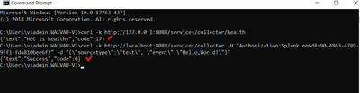

As per the below screenshot my server is not giving any health status of hec port 8088. Due to this I am not able to publish anything by using hec token in Splunk for an example :
curl -k "Authorization: Splunk ee6d8a90-4863-4789-9ff1-fda810bee6f2" http://walvau-vidi-1:8000/services/collector/event -d '{"event": "hello world"}'.
Please guide me what will issue, how I investigate further on this.

@PickleRick @marnall After further investigation I found that the tcp port 8088 is being used under another app . I removed the config from there and now all are working fine.
Issued screenshot:
Resolved screenshot:
Thanks both of your support and suggestions.
