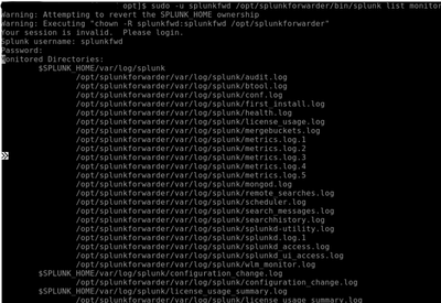

From UF, ./splunk list monitor

4. From Linux UF, ./splunk list monitor list all log name to be forwarded.
