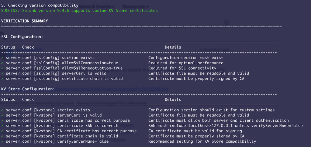

We have encountered similar kvstore issue once upgraded to splunk 9.4.6.  Splunk support recommended to use this kvcertverify tool:
Server.conf snippet for reference:
[sslConfig]
serverCert = $SPLUNK_HOME/etc/auth/mycerts/splunk-hf.pem
caCertFile = $SPLUNK_HOME/etc/auth/mycerts/splunk-hf.pem
caPath = $SPLUNK_HOME/etc/auth/mycerts/splunk-hf.pem
[kvstore]
disabled = false
Here is the structure of our certificate chain (.pem) file:
$ grep "BEGIN\|END" splunk-hf.pem
-----BEGIN CERTIFICATE-----
-----END CERTIFICATE-----
-----BEGIN PRIVATE KEY-----
-----END PRIVATE KEY-----
Note:  The .pem file was created as per this splunk doc
