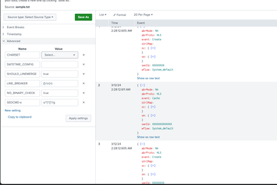

Can you please add the below configurations in props.conf and try?
[YOUR_SOURCETYPE]
SEDCMD-a=s/^[^{]*//g
Note: it will be applied to new events only.
I hope this will help you.

@kamlesh_vaghela . I want to get full event to splunk. The below sedcmd will remove first few lines and then the remaining event is viewed as json format. I want to keep full event as it is. Is there a way we can apply props/transform in which splunk identifies both structured(json) and unstrutured formatted data.
