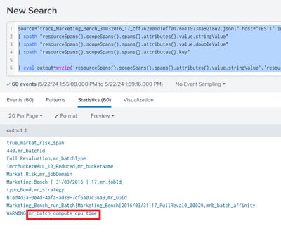

I have tried the following. But there is an issue
source="trace_Marketing_Bench_31032016_17_cff762901d1eff01766119738a9218e2.jsonl" host="TEST1" index="murex_logs" sourcetype="Market_Risk_DT" "**strategy**" 920e1021406277a9
| spath "resourceSpans{}.scopeSpans{}.spans{}.attributes{}.value.stringValue"
| spath "resourceSpans{}.scopeSpans{}.spans{}.attributes{}.value.doubleValue"
| spath "resourceSpans{}.scopeSpans{}.spans{}.attributes{}.key"
| eval output=mvzip('resourceSpans{}.scopeSpans{}.spans{}.attributes{}.value.stringValue','resourceSpans{}.scopeSpans{}.spans{}.attributes{}.key') | table output
The order is not coming out correctly. In red, we can see that
WARNING is with mr_batch_status, not mr_batch_compute_cpu_time - That is because they are both extracting independently and not synced to each other. How do I get them to extract the same?

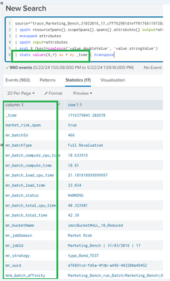

In the end, I used this however it was not clear to me why I did not need to reference the newly created X_Mr. I could go straight to MR
source="trace_Marketing_Bench_31032016_17_cff762901d1eff01766119738a9218e2*.jsonl" host="TEST2" index="murex_logs" sourcetype="Market_Risk_DT" "**strategy**" 920e1021406277a9
| spath resourceSpans{}.scopeSpans{}.spans{}.attributes{} output=attributes
| mvexpand attributes
| spath input=attributes
| eval X_{key}=coalesce('value.doubleValue', 'value.stringValue')
| stats values(X_*) as * by _time
| stats sum(mr_batch_load_cpu_time) as batch_load_cpu_time sum(mr_batch_load_time) as batch_load_time sum(mr_batch_compute_time) as mr_batch_compute_time sum(mr_batch_compute_cpu_time) as mr_batch_compute_cpu_time by mr_strategy
 This created the below table that I was looking to do
What I don't understand is at this point I can only see the new fields X_mr
I added in a "| stats values(X_*) as * by _time" and we are back to the original - I don't get that.
ITWhisperer
This line removes all the other fields. You would need to add more fields to this if you want more fields to be kept.
