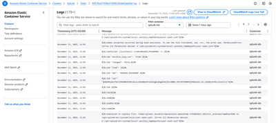

Hi,
I'm trying to deploy Splunk indexer and Heavy forwarder using image 9.4 on ECS Managed Instance using EBS volumes but the problem that i'm facing is a permission denied all what I'm doing just put the environments needed and  such as:
ENV SPLUNK_START_ARGS="--accept-license"
ENV SPLUNK_PASSWORD="ChangeMe123!"
ENV SPLUNK_ROLE="splunk_heavy_forwarder"
ENV SPLUNK_INDEXER_URL="idx1.splunk.local:9997"
ENV SPLUNK_GENERAL_TERMS="--accept-sgt-current-at-splunk-com"
So, i appreciate if someone can advice

@yassenfouadanis  from the logs i can see the issue is because of permission
when mounting EBS volume to the container, you should set the owner as splunk
before launching splunk use the below command to change the permission to splunk as a owner
chown -R splunk:splunk /opt/splunk
