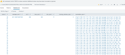

You can see by the screenshot below that I hit some Splunk limits when trying to put together a MV field with 1,500 entries (truncates to 250). But other than that it seems to work.

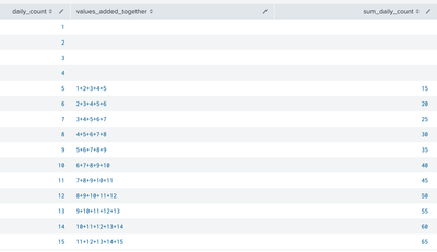

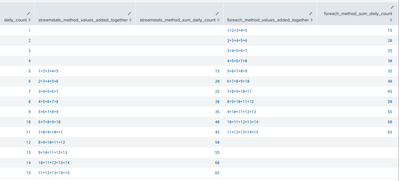

You can check if thats the case with this.
| makeresults count=15
| fields - _time
| streamstats
count as daily_count
| streamstats window=5
list(daily_count) as values_added_together,
sum(daily_count) as sum_daily_count
As you can see in the column "values_added_together" gives you a list of numbers that are being added together on each step.
This is basically the same thing the foreach loop is doing against the multivalue field just using the previous 4 entries to add instead of the next 4 entries. Ultimately, I think you would get the same results, just shifted a couple of rows depending on which method is used. The streamstats method also will include the first few entries summing up less than 5 values because there is not 5 preceeding values until it gets to row 5.

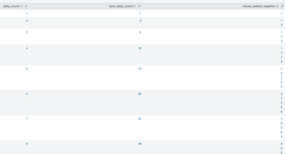

Another screenshot as a POC:
And to really drive it home here is a tabled visual representation of both methods together in comparison to their respective row of the original daily_count value.
Values are all the same just shifted depending on if the moving window is looking back/forward

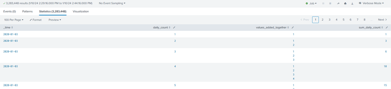

Did I set this up correctly?
Note: I posted 5 days to simplify the use case but I need 28-day sums.
| inputlookup direct_deposit_changes_v4_1_since_01012020.csv
| eval _time = strptime(_time,"%Y-%m-%d")
| sort 0 _time
| streamstats count as daily_count by _time
| streamstats window=28 list(daily_count) as values_added_together, sum(daily_count) as sum_daily_count
| table _time, daily_count, values_added_together, sum_daily_count
I ended up with over 3 million rows when it should have been around 1,460.
Because it wasn't grouped by _time (%Y-%m-%d).

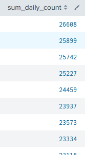

However, the foreach code produced the results I was looking for.
| mvcombine daily_count
| eval cnt=0
| foreach mode=multivalue daily_count
    [| eval summation_json=if( mvcount(mvindex(daily_count,cnt,cnt+27))==28, mvappend( 'summation_json', json_object( "set", mvindex(daily_count,cnt,cnt+27), "sum", sum(mvindex(daily_count,cnt,cnt+27)) ) ), 'summation_json' ), cnt='cnt'+1 ]
| rex field="summation_json" "sum\"\:(?<sum_daily_count>\d+)\}"
| fields sum_daily_count
| mvexpand sum_daily_count

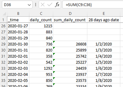

I confirmed these were correct using Excel.
Now I must add _time (%Y-%m-%d) to the results.
