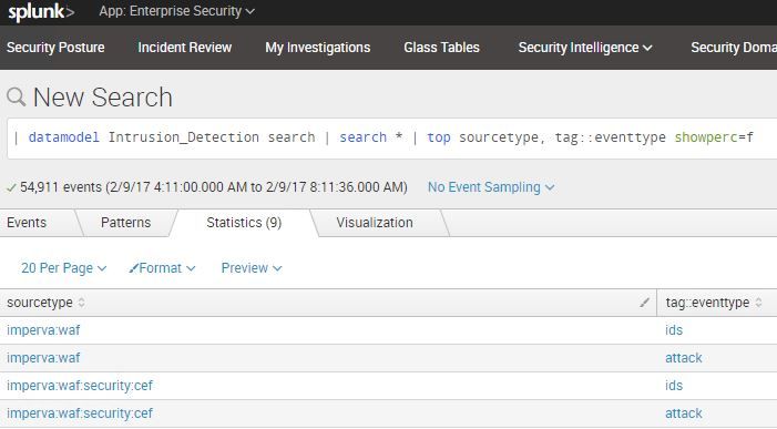

Hi,
When I search all indexed data against "Intrusion Detection" data model from Search & reporting app's context, Splunk can correctly identify data from Imperva and eStreamer both, based on the tags ids, attack.
But when I run the exact same search from context of Enterprise Security, only data from Imperva is returned. It does not see eStreamer data.
I have verified that under CIM Setup for "Intrusion Detection" data model, there are no restrictions on which indexes it can search.
Also, knowledge objects which are normalizing eStreamer data do have global permissions.
What else could we be missing?
Many Thanks,
~ Abhi

Hello,
does your eStreamer app is imported by ES ?
See here for more details: https://answers.splunk.com/answers/252035/how-to-make-url-toolbox-available-from-the-splunk.html
att35
Builder
Thanks a ton. That was it.
We have both eStreamer app and the corresponding TA installed. There were few objects needed by data model which were missing in TA but present in the app(private to the app), so I had just made their permission global assuming that now ES should be able to see them. I did not know that ES by default is looking only for those TA's and SA's and the objects in eStreamer app wont be considered.
I cloned these objects and this time assigned the context to the TA Sourcefire, which is already part of the Regex ES looks for. This resolved the issue and now ES is able to see eStreamer sourcetype as well.
