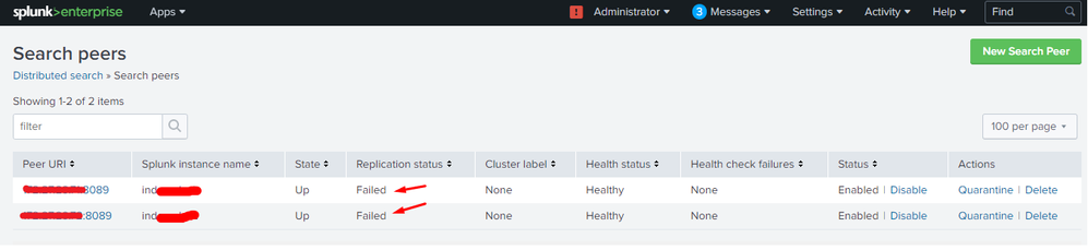

It seems like a queuing issue, what I have investigated is that the possible cause is that I have activated all the notable event functionalities
This process helped me not to have the problem so frequently, but it still happens https://splunkonbigdata.com/2020/07/21/concurrent-historical-searches-in-splunk/
There are other errors that I have pending to solve and I do not know if they are related
other times when the searches are not completed or the graphics are not loaded, an error appears that refers to loss of connection with the peer, that is, with the 2 indexers, after 2 min it normalizes, but it happens at least 5 times every 10 min

1. This dashboard is fed by a KV Store Collection called "ess_notable_events"
2. The "ess_notable_events collection is fed by a Scheduled Search called " ESS - Notable Events"
3. In order for searches to be run from a SH, the indexing tier must have a "Common Knowledge Bundle" installed on ALL indexers.  If you don't have a common baseline across all indexers the scheduler on the SH will quit running searches.
To me it sounds like you have some issues between your ES SH and your indexing tier, and I would start here for the trouble shooting process.
 a. How big is your bundle on the SH in /opt/splunk/var/run/ *.bundle
b. Is your ES SH on the same network as your Indexers?
c. Are you system running with plenty of resources and no network connectivity issues between them.
d. you can increase settings like timeouts between the SH and indexers for 8089 communications, but if you are having to do this on a small splunk setup, then something above might be causing your issues.
e. are these physical systems or are you running on an over-subscribed virtualized hardware?
Lot of things to look at here, and most all of these are addressable.  If you need further help you might start with a support ticket to help you diagnose the issue .
