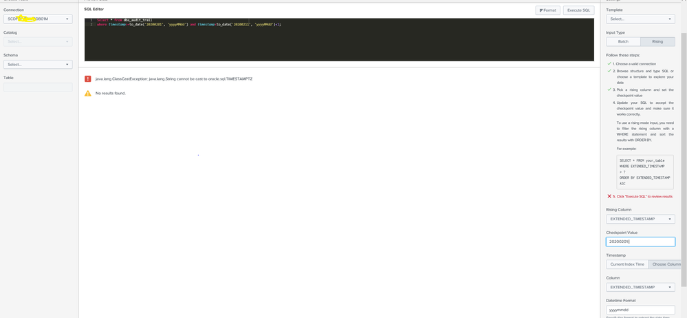

i am trying to query the Oracle DB using the statement attached in the case, the query works fine for the batch input, but when i try to put rising column and check point value it throws the error as attached in this case. please update on how to proceed in this case.alt text

I'm not sure which side of this equation it's complaining about. A few things to check:
1) Please confirm your source timestamp column is of type TIMESTAMPTZ
2) Try using only one timestamp comparison.
3) Grab a value from the DB for timestamp (any one of them) and try using that particular construct.
A quick search for this shows it looks like your syntax is correct for the to_date, but ... maybe it needs something else.

sorry to much oracle for me, can you tell me where to check for the source timestamp column
