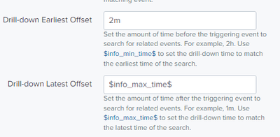

I'm trying to configure Drill-down Earliest Offset in my Notable from Adaptive Response Action.
I'd like to run the Drill-down  search setting as earliest 2 minutes before the earliest time of the search: $info_min_time$ - 2minutes.
I'm trying this configuration but seems not to work properly.
Is there a way to do so? Is there a way to set earliest in the Drill-down search?

Hi @VatsalJagani ,
I've tried setting  in the drill-down offset 120 instead of 2m, the search ends but runs in a wrong range: it is as if the offset is not anymore the $info_min_time$ but the time I click on drill down.

Hi @VatsalJagani,
it is not possible to set that value in the Drill-down offset, a warning appears that the value must be an integer if not $info_min_time$.
On the other hand, I've tried setting earliest=$info_min_time$-2m in the drill-down search  with no success since when I click on drill-down this error appears:
