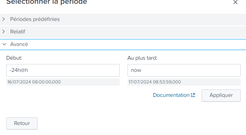

ok is the latency explain in seconds?
Imagine the latency is 180
does it mean i have to put -3m@m in earliest and now() in latest?

VatsalJagani
No.
Let me explain with example.
  • Event with timestamp 3:14 comes at 3:17
  • Event with timestamp 3:15 comes at 3:18
  • That means if you make a search at 3:18 with earliest=-2m@m latest=now
    • This means it will search event between 3:16 to 3:18
    • Locally this will not include any events, never. Because events are always 3 minutes delay.
Solution is to never search last 3 minutes when writing search and wait for those events to populate in the next schedule with:
  • earliest=-63m@m latest=-3m@m
  • OR
  • earliest=13m@m latest=-3m@m
  • OR
  • earliest can be anything but keep the latest in a way that it never search recent events, to keep events being missed issue.
There is another solution as well with _index_earliest and _index_latest, but that's topic for another time. (a bit complicated)
I hope this helps!!
