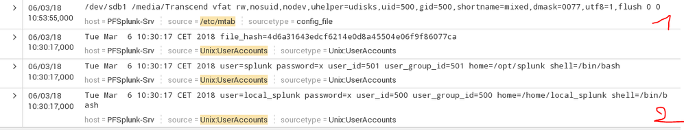

Hello,
I want information about the usb keys mounted on the system but the / var / log / messages or the /var/log/audit/audit.log do not give enough interesting information about the USB sticks.
So I want to use the data contained in the / etc / passwd and the / etc / mtab to correlate the information and thus deduce in a table the login of the current session and the name of the usb key mounted on it.
I used the add-on unix to generate the information contained in the / etc / passwd but this add-on does not propose me to generate the information of / etc / mtab, so I configured splunk for it to monitor this file and since this file is dynamic, when a line is added at the end of the file when we insert a usb key, this line is automatically generated on splunk.
Now I want to find a way to correlate message 1 with message 2.
I want to correlate the uid ie in the message 1 we see that there is the uid 500, so I will use the message 2 to deduce that 500 = local_splunk. After correlating the uids I want to make a table that will show me the uid, user, usb key name mounted.
Thank you

amir_thales
Something like that but the field user is empty:

amir_thales
@elliotproebstel,
I think this time, I found the request that I needed and with the time and date thank you for your help.
    sourcetype="mtab_executer" OR source="unix:useraccounts"
    | rex max_match=0 "(^|\n)(?<usb_key>\/\S+\s\/\S+)"
    | eval user_id=coalesce(user_id, uid)
    | eventstats latest(user) AS user BY user_id
    | convert timeformat="%H:%M:%S" ctime(_time) AS c_time
    | stats latest(c_time) AS Time, latest(user) AS user, latest(user_id) AS user_id, count BY usb_key
Result:
Amir

elliotproebstel
Champion
Sure thing, although I don't quite understand what you're representing when you have a timestamp on the same line with the count. Presumably, that usb_key wasn't seen 1936 times at a single moment - so you might give some thought to what that communicates. But certainly you know your intentions better than I do.
I think this should do it:
your base search
| rex max_match=0 "(^|\n)(?\/\S+\s\/\S+)"
| eval usb_time=if(source="/etc/mtab", _time, NULL)
| stats latest(usb_time) AS _time, list(user) AS user, list(user_id) AS user_id, count BY usb_key

amir_thales
i want to know how can i correlate uid of the message 1 with the uid in the message 2 and deduct the user and display the event when it appears with the names of the usb keys that I extracted. Because i have i problem which is, when event appear splunk only takes the usb key events alone and does not correlate the uid in the event with the uid of the message 2. is there not a function that basically allows to set up a dynamic array or when the 'event 1 appears it will directly dig into it and deduce that uid 500 = local_splunk.
Still sorry for the double post

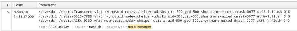

amir_thales
@elliotproebstel,
yes, please.
I did this for now but I can only get the first 2 usb key not the 3:
my search | rex "(\n)(?<usb_key>/\w+/\w+\s+/\w+/\w+[-\w+])"
In the picture after, there is my event which i want use:
And what i extract with my rex:
Thank you
Amir
elliotproebstel
Champion
Does this work?
| rex "^(?<usb_key>\/\S+\s\/\S+)"
amir_thales
yes, it works for the first line /dev/sdb1 /media/Transcend but not for the 2 others.
it's well extracted to /dev/sdb1 /media/Transcend
amir_thales
but my main problem is to extract the 2 from below.
Sorry for the double post.
elliotproebstel
Champion
Got it. Does this work for you?
| rex "(^|\n)(?<usb_key>\/\S+\s\/\S+)"
amir_thales
it is the same problem it works but with the first line.
it extract me /dev/sdb1 /media/Transcend but not the 2 others.
elliotproebstel
Champion
Ahh, I was forgetting the max_match option, which may be biting us. Sorry for shooting in the dark a bit here, but I don't have access to a Splunk instance at the moment, so I can't test things before posting. I'm going to shotgun several options here, and you can test any/all of them:
First:
| rex max_match=0 "(?s)(?<usb_key>\/\S+\s\/\S+)"
Second:
Third:
| rex max_match=0 "[\S\s](?<usb_key>\/\S+\s\/\S+)"
I'm hoping one of these works!
amir_thales
It's not a problem that, you take your time to help me on the contrary I'm happy to learn.
the first 2 are good, I have the 3 that are extracted.
Is it possible that you explain:
rex max_match = 0 "(^ | \ n) (? <usb_key> \ / \ S + \ s \ / \ S +)" and [\ S \ s] which is in the 2nd expression.
thank you
Amir
elliotproebstel
Champion
Great! And I'm happy to explain!
The snippet (^|\n) in the first is looking for ^, which means the start of the line OR \n, which is a newline character. I was figuring that the first line wouldn't be preceded by a newline, so we'd need ^ to grab the first one.
The [\S\s] was also a bit of a trick to look for any character at all (including a newline), because it matches on \S (any non-whitespace character) or \s (any whitespace character). But I expect it probably failed to grab the first line, since the first usb_key value had nothing at all before it. It might work if revised like this:
| rex max_match=0 "[\S\s]?(?<usb_key>\/\S+\s\/\S+)"
because that makes the [\S\s] optional (zero or one matches will pass).
amir_thales
ok thank you so much for your help @elliotproebstel .
I learned a lot today 🙂
Amir
elliotproebstel
Champion
My pleasure!
