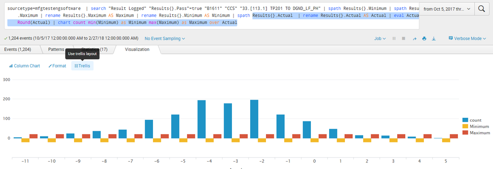

Plot is till not right. I guess I need to do more research.

@Lynyrd, seems like you are using Trellis Layout. Just turn it off using the Trellis option as available in your sample screenshot and there should be single chart with three series.
PS: Splunk does provide an option for developers to write custom search commands and also the option to create custom visualization in case current SPL or built in visualizations/custom visualizations available on Splunkbase do not suit your needs.

that code gave me three individual plots. I need Min Max and Actual to all be on the same plot.
I would include a picture but I don't have enough karma points.
