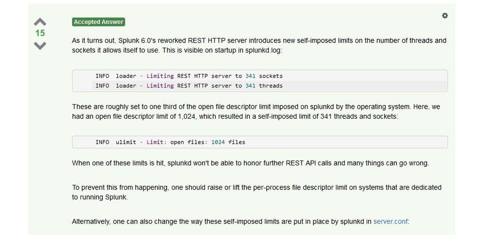

A very intersting thread at What is the cause of these socket errors reported in splunkd.log since upgrading to 6.0?
@hexx says -
Therefore, I would suggest to increase ulimit -n first. It's not worth your time to do it the other way around ; -)

it's interesting because the default on many systems of 1024 which translates into 341 actuals, according to the post, is way off the 64000 recommended value or even the unlimited available value - so there is a huge gap between this default value and a good possible value.
Look, this 1024 value is not good enough, in many cases, for plain forwarders ; -) not mention Splunk itself.
Obviously I don't know if it would solve your issue, but you need to increase 1024 in any event - it's not even a supported value by Splunk.
