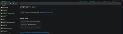

To further check, I downloaded the Config Explorer app from splunkbase and installed it on sklunk Enterprise and Splunk Cloud,
respectively, and compared them. It also installed and ran fine on Splunk Enterprise.

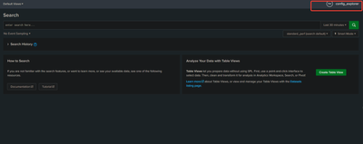

In the skunk cloud, the installation went well, but in the object view, It didn't work as it appeared different.

Config explorer also works in Splunk Enterprise as shown in the image below, but does not work in Splunk Cloud. Is there a separate setting when installing from Splunk Cloud?

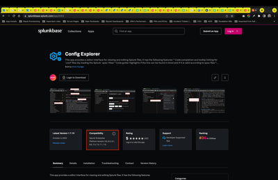

For the concern on Config Explorer, it isn't supported to be installed on the SplunkCloud platform. Please refer to the compatibility section to check the supported platforms in the screenshot below:
