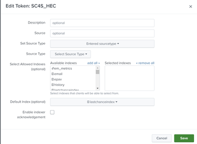

In splunk I've created the HEC token:

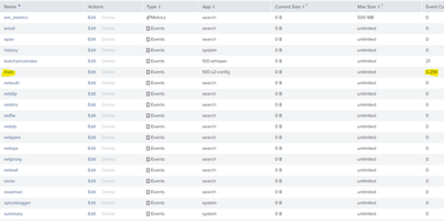

I've created the Indexes like this, looking at this everything seems to fall in the "main" index instead of "lastchangeindex", looks like that's not right, is it?

So the issue you are having is the index it lands in correct?
It is likely that SC4S hec client is sending a default index.
Hec clients settings in the payload override the settings you put on the token. Think of those as "if not set by the hec client".
https://docs.splunk.com/Documentation/SplunkCloud/latest/Data/FormateventsforHTTPEventCollector#Even...
Would check sc4s docs on setting indexes: https://splunk.github.io/splunk-connect-for-syslog/main/configuration/#log-path-overrides-of-index-o...
