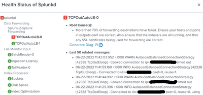

All Heavy Forwarders have this error: TCPOutAutoLB-0 - More than 70% forwarding destinations have failed.

We have Prod and Non Prod environments, about 2 weeks ago we started to get this issue on our Non Prod environment. I have compared my outputs.conf files for all my HF forwarders and have found no issues with it, telnet to the indexers from the HFs, certificates are in order.  I have also compared the Non Prod output.conf to my PROD outputs.conf files. After searching online I have not found anything about this.  Has anyone come across it before? Any help would be appreciated!

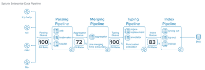

That document link really helped (thank you), at first I only checked on Splunk cloud hence it was fine. I went through all 4 HF and found that only 1 had the issue (image below).  I'm still learning so from the document, is it pointing to a parsing issue?

Nope. You should read that picture from right to left. Usually 1st which has 100% or other really high % is that what has really the issue / bottleneck. You could look from docs what all actions are done on typing pipeline. Here is link to one old answer which you could also use https://community.splunk.com/t5/Getting-Data-In/Diagrams-of-how-indexing-works-in-the-Splunk-platfor...
If the indexing queue has 100% utilization, then you must start checking from node where that node is sending it’s events.
