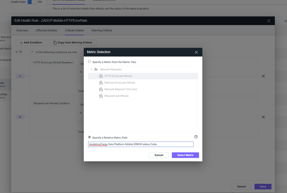

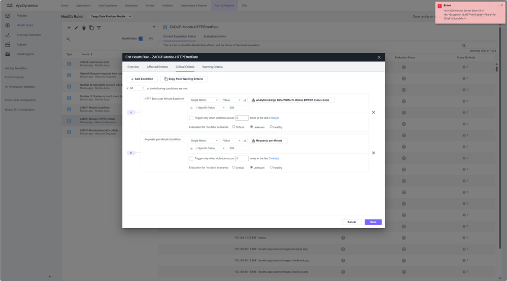

When I change the HR it shows a 500 error code
164521
New Member
I changed the metrics above and then couldn't save and display 500 error

To define a relative metric path in AppDynamics, you can do the following:
  1. Hover over a metric in the Metric Browser to get the full metric path
  2. Right-click on the metric and select Copy Full Path
  3. Truncate the leftmost part of the full metric path
  4. Use the category in the Metric Selection window as the first segment of the relative metric path
  5. Truncate everything from the full metric path that comes before that segment
    Please refer doc: https://docs.appdynamics.com/appd/23.x/latest/en/appdynamics-essentials/dashboards-and-reports/custo...
    Also, Please make sure that your select the respective correct entity from "Affect Entities" tab.
