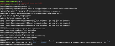

Getting error while downloading forwarder in  Ubuntu, 20.04 LTS, amd64 focal image built on 2025-04-08
Reinstalled, tried a bunch of commands to check for any issues, but could not find any solution. Tried different versions of the ubuntu architecture, still the same. This is stopping my instance to run splunk [ Allowed http traffic, firewall port open..etc]
cd /opt/splunkforwarder/bin/ splunk validate files
Setting up splunkforwarder (9.4.1) ...
find: ‘/opt/splunkforwarder/lib/python3.7/site-packages’: No such file or directory
find: ‘/opt/splunkforwarder/lib/python3.9/site-packages’: No such file or directory
complete

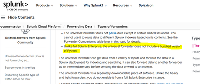

Splunk UF should not have a python site-packages as UF installation does not include Python.
Please can you confirm what manifest file you have in /opt/splunkforwarder? If you are using 64-bit version it should be called splunkforwarder-9.4.1-e3bdab203ac8-linux-amd64-manifest.
This manifest file does not contain reference to the Python libraries.

@livehybrid @kiran_panchavat PFA, this is so weird, i have seen few cases like this in the community with no solution. I tried multiple OS of Linux and older versions of forwarder, but its still the same.. Please find a solution as i tried a lot of versions here...
older version 9.4.0 splunk forwarder - splunkforwarder-9.4.0-6b4ebe426ca6-linux-amd64-manifest

Just to check - apart from the errors you mentioned - Does Splunk install correctly? Those errors dont necessarily mean there is an issue - its likely that part of the debian preinst script which calls a "temp_splunk-preinstall" file - this is looking for those locations to do *something* - "find" is usually used to "find" something (file/folder) and then do something to it like update permissions or something.
If the find returns no files the script looks to continue, finally finishing with "complete" - at this point I'd expect your install to be complete - Since you splunk validate command returned a success I thing these "errors" are benign.
The existence of them is either a mistake in that script - OR - it could be for something we arent necessarily aware of.
Either way, If the files get installed then I'm confident this isnt an issue.
