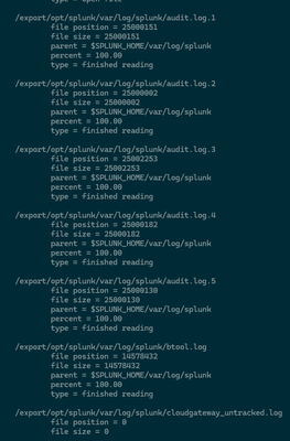

Abass42
Communicator
For a pickle, that was a very fast response.
But running those commands looks like it outputs the internal logs. All of the logs monitored at /export/opt/splunk.
Doesn't really show anything other than those directories.

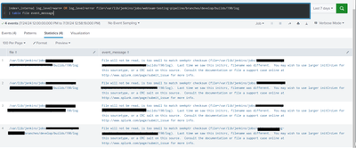

That makes sense. I was able to find some errors in Splunk _internal index
DO i just need to salt every file? How would i re-ingest those, or why are those not ingesting, but the other ones are?
PickleRick
It's hard to say without knowing the actual files. But generally crcsalting is rarely used. Usually - when the files have relatively long common beginning parts - it's better to increase the size of the header used for crc calculation.
