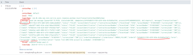

Hi team , from above screenshot can you suggest how can i extract SEP013 against "errorCode":
I need count of events for SEP013
Note : am planning to put dedup on order id , so i will get correct count

It would help if you post the data as text instead of a photo of it.
PickleRick
Honestly (yes, I know it is not helping in the immediate problem at hand but might save you some time in the future), this is a very ugly data format. I suspect that someone just receives data with a third-party solution which adds its own headers and forwards it to Splunk. The result is that you have some structure which Splunk is able to parse (the "outer json") and within that you have completely unparsed message field. And this field is "kinda like a json but not quite" so it doesn't parse properly (and I suspect there can be other types of events in that message field so no single parsing schema would work here).
In the long run it would be best if you could force admins of your source solution to provide data in a more sane format.

Hi @bhaskar5428,
this seems to be a json format, so if you use INDEXED_EXTRACTIONS = JSON in the props.conf or if you use the spath command (https://docs.splunk.com/Documentation/Splunk/9.2.2/SearchReference/Spath) in the search you should be able to extract your fields.
It's also possible to use the rex command to extract the field, but to do this I need an example of your data in text format (not a screenshot), using the Inser/Edit code sample button (the one with "</>").

so basically i would like to find all error code with their order id
i want to use below main search
index = app_events_sdda_core_de_prod source="/home/sdda/apps/logs/sep-app/app-json.log" level=TRACE
so what i posted earlier part of above search
i want to extract all errorcodes and their order id
Later i am planning to put bar chart for the same based on range
hope you got requirement

Hi @bhaskar5428 ,
this is the regex to extract the highlighted fields:
| rex "\"orderId\":\"(?<orderId>[^\"]+)\"},\"error\":\{\"errorCode\":\"(?<errorCode>[^\"]+)\""
that you can test at https://regex101.com/r/XkBntG/1
but I hint to try with INDEXED_EXTRACTIONS = JSON or spath.

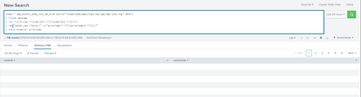

btw, i tried below rex , any idea why its not showing any records

bhaskar5428
adding command which i have tried but not working , need help correct rex patternt
|fields message
|rex field=_raw "errorCode=(?<Error>[^,]*)"
|rex field=_raw "orderId":(?<Order>\w+)"
|table Error, Order
