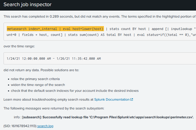

teeeebro
Loves-to-Learn
Yes - I need a little more guidance, please.
I created the CSV which contains a list of ALL my server hostnames.  The search read the file, but there are no results.
This was my search
gcusello
Hi @teeeebro,
the lookup is called "perimeter.cav", contains at least a column called "host", you creted it and you created also the related lookup definition for this lookup, is it correct?
then, what do you mean with "no results"?
at least you should have the hosts from lookuop and the hosts from _internal, which resuld have you?
Ciao.
Giuseppe
