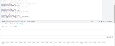

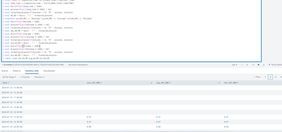

I am working on the below query in which I want to calculate the lead_time in HH:SS. This query is giving me some results in statical mode but not giving any results with linechart. Please help me fix it.
Results with statical mode.
No results showing while using "line chart"

ITWhisperer
The values need to be numeric e.g. number of minutes, you can't use string values such as HH:MM to display on a chart

Below results currently I am getting by using above query.
