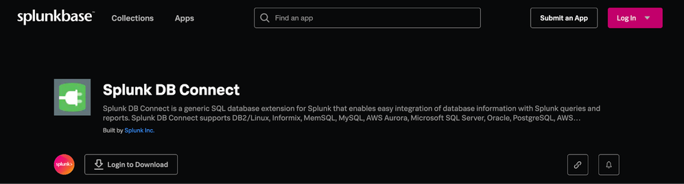

Splunkbase is Splunk’s app marketplace. Splunk platform system admins turn to Splunkbase to find apps that solve their problems so that they don’t need to build out every solution themselves. From streamlined data ingestion to compelling visualizations to proactive alerting to integrations with other systems, Splunk apps are hugely valuable to our customers.
The following screenshot shows an example of the Splunk DB Connect app listing on Splunkbase.
Publishing your app to Splunkbase is a great way to reach these customers, but how do you make sure the right people are able to discover and download your app? At .conf22, Burch, Splunker and Splunk Trust member, described how to create a good Splunkbase listing in his breakout session, Best Practices and Better Practices for App Development. According to Burch, a good Splunkbase listing has the following characteristics.

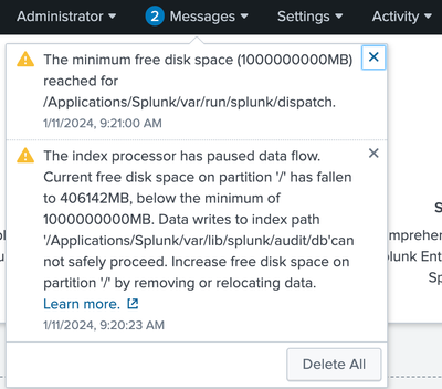

Message Your Users through the Bulletin Board
From time to time, you might need to reach out to users with specific roles to communicate key information about your app. For example, say you need to remind admins that it’s time to renew their licenses, prompt sc_admins to complete installation, or let users know that they must update their apps before updating their Splunk platform installations to avoid breaking changes.
You can message app users with specified roles using the bulletin board. The bulletin board lets you use the Splunk platform REST API to create custom messages that display in Splunk Web for users assigned to the roles that you specify. Users can view bulletin board messages through the Messages menu when they log in to Splunk Web, as shown in the following image.
For more information about bulletin board messages, see Message users in apps for Splunk Cloud Platform and Splunk Enterprise.
