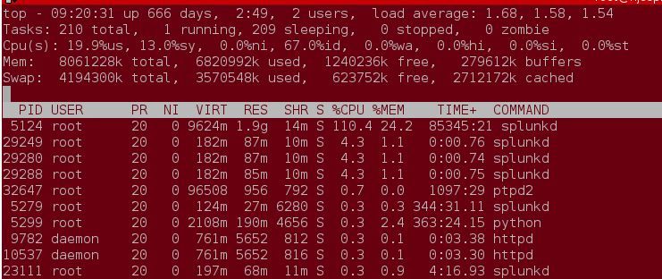

Our 6.6.2 search head (linux 2.6.32-573.18.1.el6.x86_64) is constantly low on free swap space,
I tried swapoff -a (clears swap), swapon -a
but after some time, splunk eats up almot 4 gigs of swap. Its also consistently maxing out CPU use
where would bea good place to troubleshoot this? Its not an indexer so not sure why such high CPU use here.

checked any running jobs, have a few searches, but nothing major,
/opt/splunk/bin/splunk list jobs
Asynchronous jobs:
    Job id: scheduler_bWlrZS5yZWlkZXI__search__RMD5452ecaa3d81bade9_at_1517928000_19793, ttl: 438
    Job id: scheduler_bWlrZS5yZWlkZXI__search__RMD5452ecaa3d81bade9_at_1517927700_19745, ttl: 139
    Job id: scheduler_bWlrZS5yZWlkZXI__search__RMD5f91236005de9cb9c_at_1517927400_19669, ttl: 1042
    Job id: scheduler_bWlrZS5yZWlkZXI__search__RMD5f91236005de9cb9c_at_1517926500_19506, ttl: 141
    Job id: scheduler_bWlrZS5yZWlkZXI__search__RMD5f91236005de9cb9c_at_1517855400_10230, ttl: 13641
    Job id: scheduler_bWlrZS5yZWlkZXI__search__RMD5f91236005de9cb9c_at_1517853600_9906, ttl: 11845
    Job id: scheduler_bWlrZS5yZWlkZXI__search__RMD5452ecaa3d81bade9_at_1517846400_8549, ttl: 4641
    Job id: 1517428177.10568377, ttl: 0
