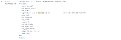

I want to know if it is possible to show the number of impacted records in last 15 mins for the below search:
Query: index = events_prod_tio_omnibus_esa ( "SESE023" OR "SESE020" OR "SESE030" )
Result:
Requirement :
For the above search, if the search is executed at :
11:30 ==> It will show 0 records
11:40 ==> It will show 2 records (as the last event raised on 11:37:14 is having 2 records and currenttime - event time < 15 mins)
11:50 ==> It will show 2 records (as the last event raised on 11:37:14 is having 2 records and currenttime - event time < 15 mins)
11:55 ==> It will show 0 records (as the last event raised on 11:37:14 is having 2 records but currenttime - event time >15 mins)

Hi @ITWhisperer
My requirement is to fetch the value from the latest event (even if I restrict the search to 30 mins).
Example :
Query : index = events_prod_tio_omnibus_esa ( "SESE023" ) sourcetype=Log_mvs
| rex field=msg "(ADV|ALERT REACH)\s* (?<Nb_msg>[^\s]+)"
| rex field=msg "NB\s* (?<Msg_typ>[^\s]+)"
| table Nb_msg
Result :
I want to display the value "Nb_msg" in the result if there is any event in the last 15 mins. if there is no event in the last 15 mins , then display the value "0" in the result.
Currently with the query (attached above) , i am getting the value "Nb_msg" from all the events generated in last 15 mins.
