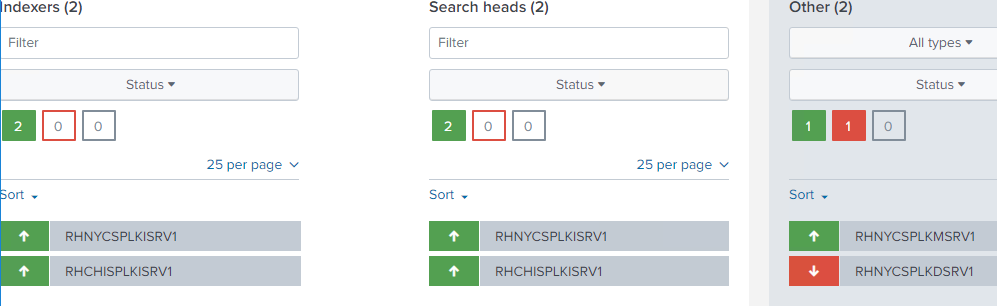

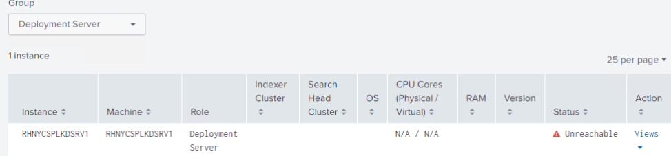

Hi,
I'm currently stuck on an issue where my Deployment Server seems to not be communicating with the same group as the other members. The server is listed as "Offline" or "Unavailable" when accessing the Monitoring Console. I believe this may be effecting clients communicating with the deployment server receiving apps and config information. I tried to see if any services are currently not running on the Deployment Server but nothing has stood out. The Deployment Server only lists itself when I access the Monitoring Console (it's in Distributed Mode). Not sure what other details are needed as I am kind of new at this but included some pictures to help describe my situation.
Any assistance is much appreciated. Thank you.

On the MC, go to Settings -> Distributed search -> Search peers and see what it tells you. Try disabling the existing entry for DS and try re-adding it. Try adding it by IP address instead of hostname (perhaps you have a DNS problem).

Can you go to monitoring console-->Settings and general setup.. Distributed and reset---> apply and restart server.. might be that will work.

Well I did that and it is still showing the same status. And yes I stopped and started the Splunk service
