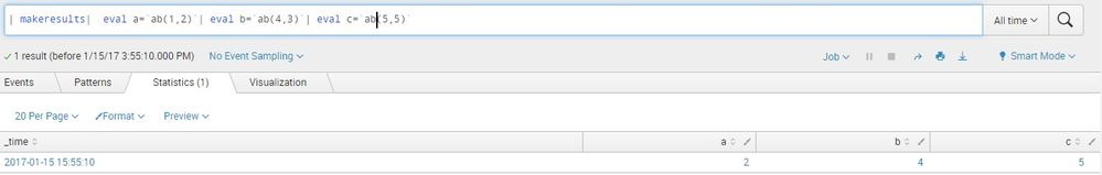

If really it is about an example for which iseval=1 works, here is one with arguments as constants. Might not work with field names as parameters though:
$SPLUNK_HOME$\etc\users\admin\search\local\macros.conf
[ab(2)]
args = p,q
definition = case($p$ > $q$, tostring($p$), $q$ > $p$, tostring($q$), 1=1, tostring($p$))
iseval = 1
And here is the output

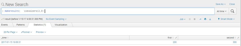

For macro with iseval=0, it should look something like:
[isevalzero(2)]
args = p,q
definition = eval first=$p$*100 | eval second=$q$*100
iseval = 0
